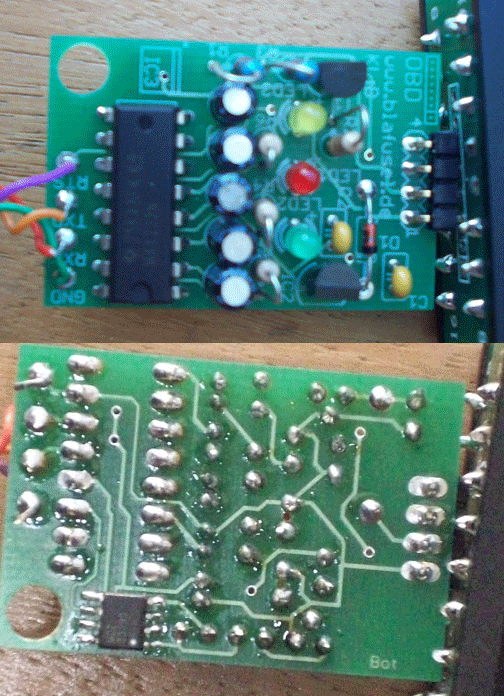

I have built my KL interface and connected it to my laptop serial interface. The LED test is ok. I have tried Carsoft 6.5 and get a "Bad Communication" error.
The laptop is running Windows XP SP2 and the car is a 2001 BMW E46.
Can you help? What should I do to start diagnosing the problem?
Paul.
